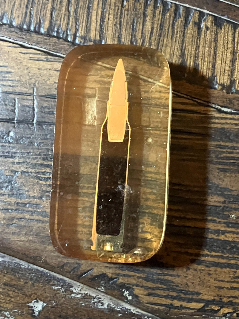

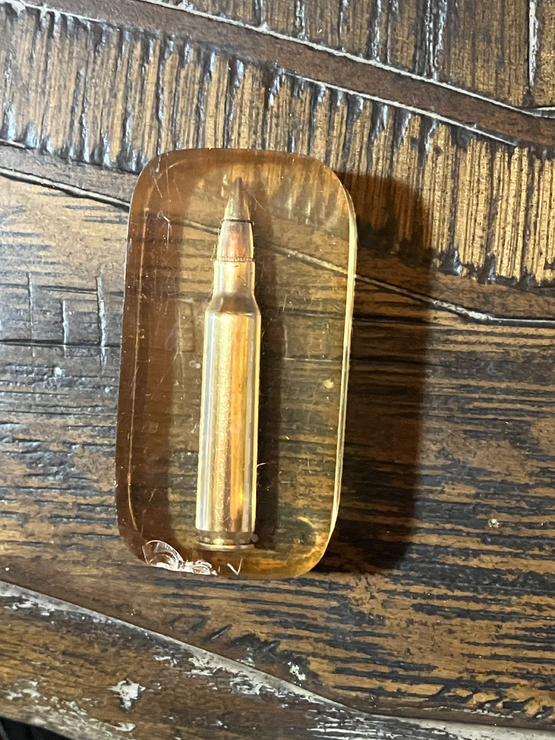

Anyway, this is what one looks like...the resin's turning yellow tho.
View attachment 5866View attachment 5867
