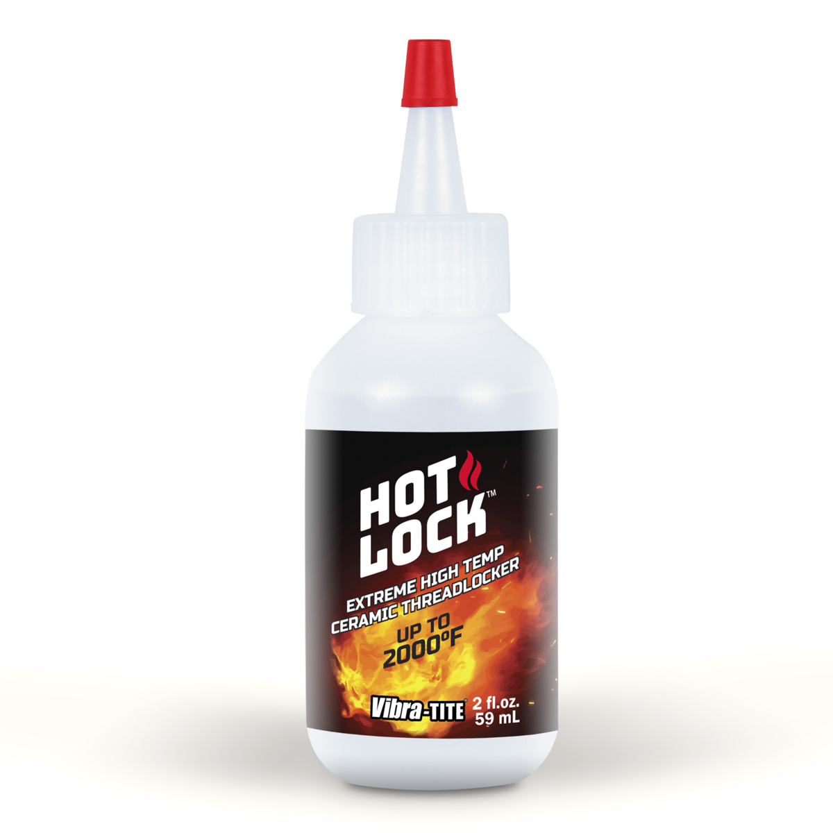

Loctite does not have a product, to the best of my knowledge that will handle the heat of being used on a gas block set screw or clamping screw. See below:
I have yet to use it, but vibratite does:
I don’t know if it is any good though. I’m typically a loctite only kinda guy.
On my most recent build I had the barrel manufacturer pin the block to the barrel, which in my limited knowledge is far superior. Loctite and similar is just glue, with a little bit of lubricant built in to keep threads from galling upon tightening/removal. Pinning the block provides an index and a mechanical lock. The other thing you could do is dimple and set screw, still use loctite because of its lubricant properties, and then stake the set screws to the block. Would be pretty easy and is also easy to remove in the future.
Loctite, vibratite & permatex all make hightemp/high strength permanent locker.
