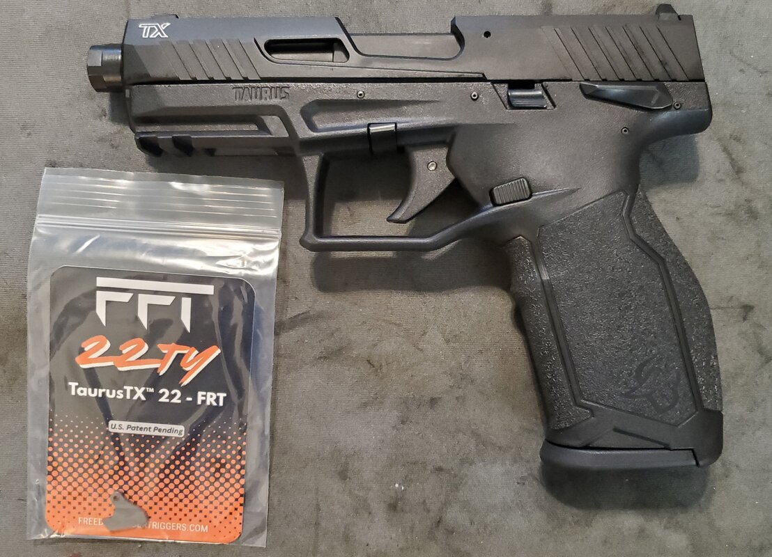

TX22 FRT
Let the games begin . . . all of this for less than $34 from sendcutsend.com
The TX22 FRTs are quite a bit thicker than they probably should be, but it's nothing I can't thin down. I haven't messed with any of the 1022 versions to see what works best.

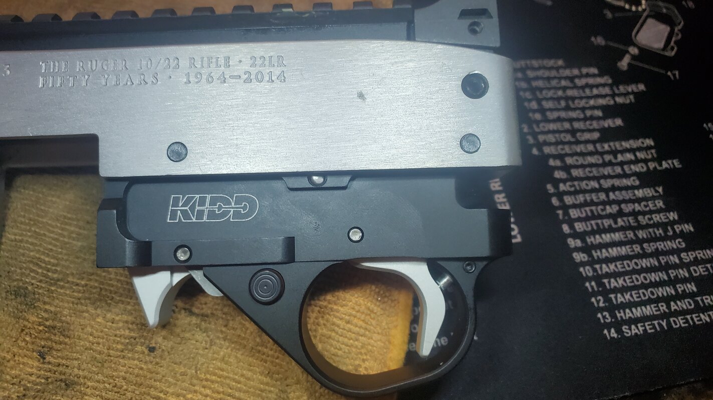

Hey Bobby, the problem I'm running into on my 10-22 is that the lower lobe on the hammer won't allow the trigger to be forced forward again until it reaches full cock thus binding the reset lever and bolt. If you clearance the lever not to bind it will start following and not release when full in battery but about an 1/8" from battery causing no ignition. I found a used hammer on eBay for 10 bucks and I'm going to reduce the lobe below the sear cut to allow the trigger to be forced forward as soon as the bolt starts back. If it works I'll let ya know here I should have it by Friday. Good luck!
