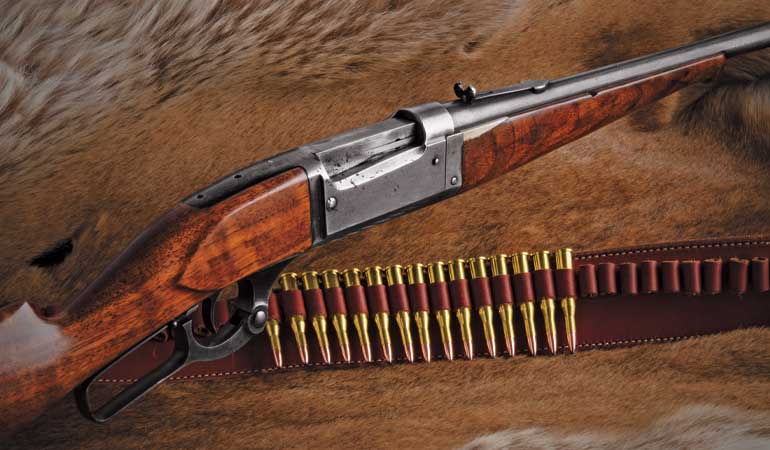

Savage 99 .22 hi power
I’ve shot a buddy’s 99 in 250-3000. It’s a nice little rifle
I love those old 99s for some reason. Mine is a newer provenance, but there’s something evocative about those vintage rifles. If I were in your boots I’d have a hard time letting that get away.
This one is missing the rear sight I’m going to clean it up tomorrow
The fact that you can buy brand new fresh ammo is pretty compelling. If the barrel cleans up you’re going to have a tough decision to make.
Just don't "clean it up" by altering the finish on the stock or metal 😂
Beats me on cleaning without removing patina since appears to have some rust.
If it were mine I'd take the stock off, just damp wipe it down.
Then soak the rust with some hoppes, then after a bit brush with a wet nylon or brass bristle brush, bore clean regular way.
Spray internals with dry cleaner, brush & blowout with air. Then wipe all down with tetra or clp.

That’s why I haven’t done it yet I’m trying to figure out how to do it
It has enough honest wear that you’re not gonna violate a collectors piece. The absolute best penetrating oil is a 50/50 mix of Acetone and automatic transmission fluid. Kroil is second. I’d probably take the stocks off and just start dosing all the screws and joints so you don’t risk buggering up pins and screw heads. It’s not a rush job so you can be as meticulous as you want to be. You can probably put a pretty good cleaning with cotton rags and isopropyl alcohol.
I’m really curious what the bore looks like.
