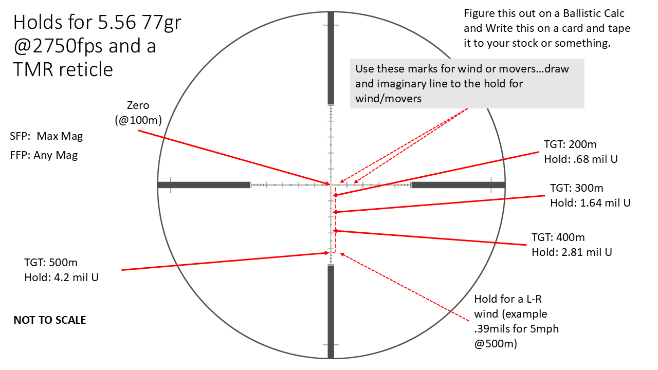

Here's a slide on using a TMR reticle. The TMR is the step between a Mildot and a milgrid reticle. Principle for use are the same for an MOA based reticle just different. Remember that mils and MOA are an angular measurement and not linear. Don't mix inches with Mil/MOA.
This is not rocket surgery nor is it futuristic voodoo witchdoctor shit. It’s 20th century tech. This has been done like this by shooters and the military since more than 40 years ago; as long as there's been a mildot reticle for a rifle. If you don't have a Kestrel or a ballistic app then figure it out on your PC/Mac...there are ballistic programs all over the internet. If you are reading this, you have the capability to do it.
You need your cartridge/projectile cal, MV, BC, and output in Mils (or MOA if there's something wrong with you). Plug your cartridge data in the solver, and then record the holds for each range you want, then make a little card and tape it to your gun. Easy peasy.
This applies to all scopes FFP or SFP that have a "rangefinding" reticle with Mils or MOA in dots, hashes/stadia, or grid. SFP keep on max mag. FFP can be on any mag.
