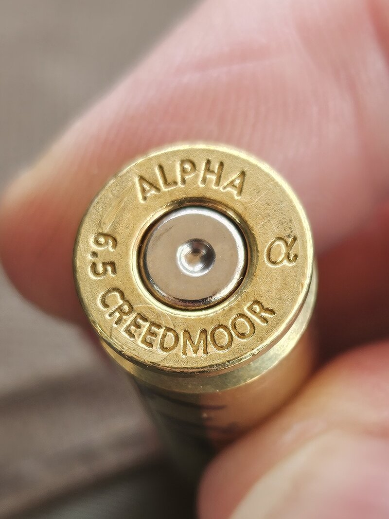

Alpha OCD LRP x1 Fireform brass

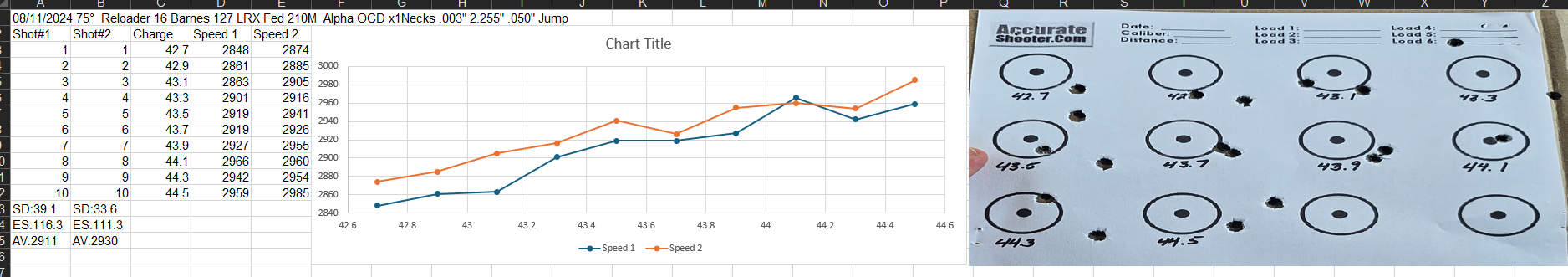

Everything arrived yesterday and today for this load. Decided on the following charge weights:
44.5
44.3
44.1
43.9
43.7
43.5
43.3
43.1
42.9
42.7
Will load 2 at each charge weight. I'm going to shoot these low to high and then high to low. Both shots will be at the same POA for each weight. Basically a double and reverse of the normal ladder test for shits and grins.

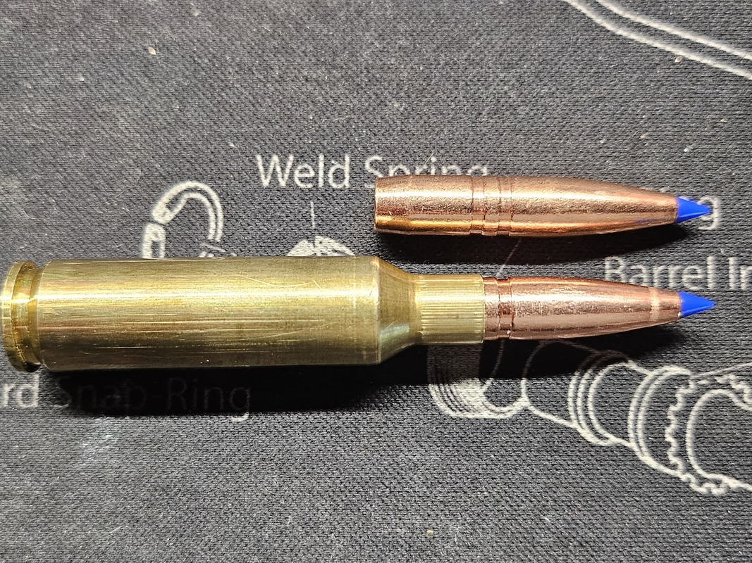

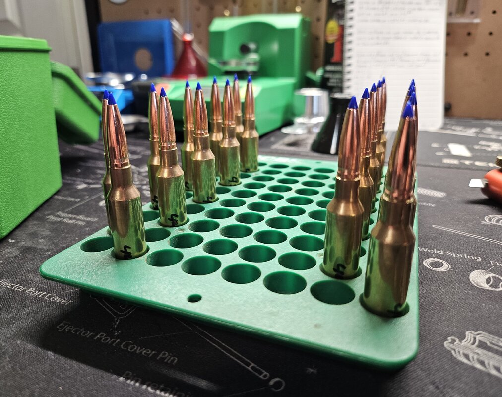

43.1 grains needed just a standard funnel. 43.3 started to have some crunch. Ended up pulling that round, starting over with a 10" drop tube. No issues until 44.1 grains. Little crunch that didn't affect OAL at all. Just like I prefer. This has produced excellent results in every caliber and every load with this case volume.
This was with a .050" jump around 2.86ish COAL. I'll need to watch this if I end up jumping further.
Those blue tips have me ready for some KU Football!!!!

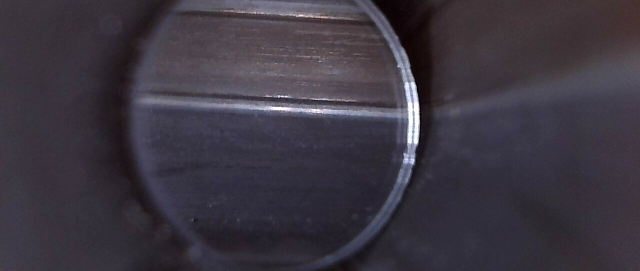

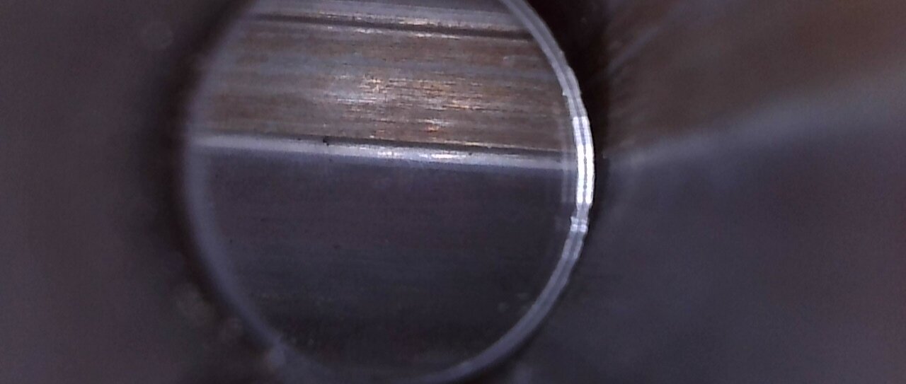

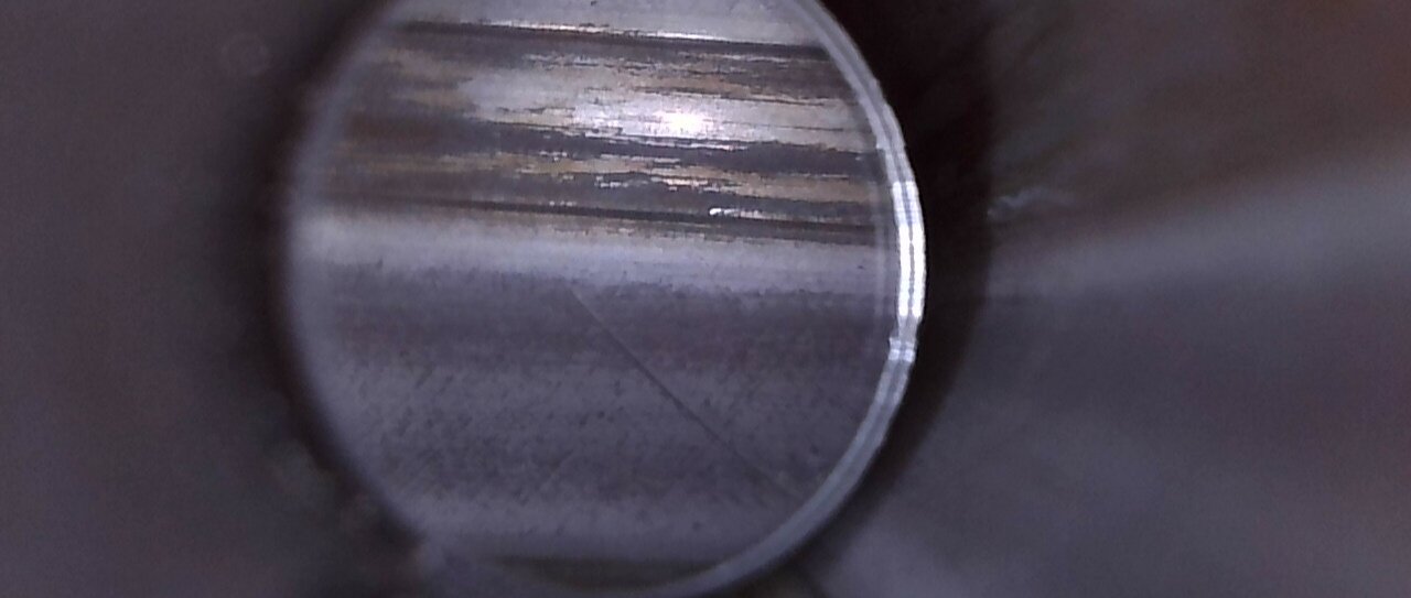

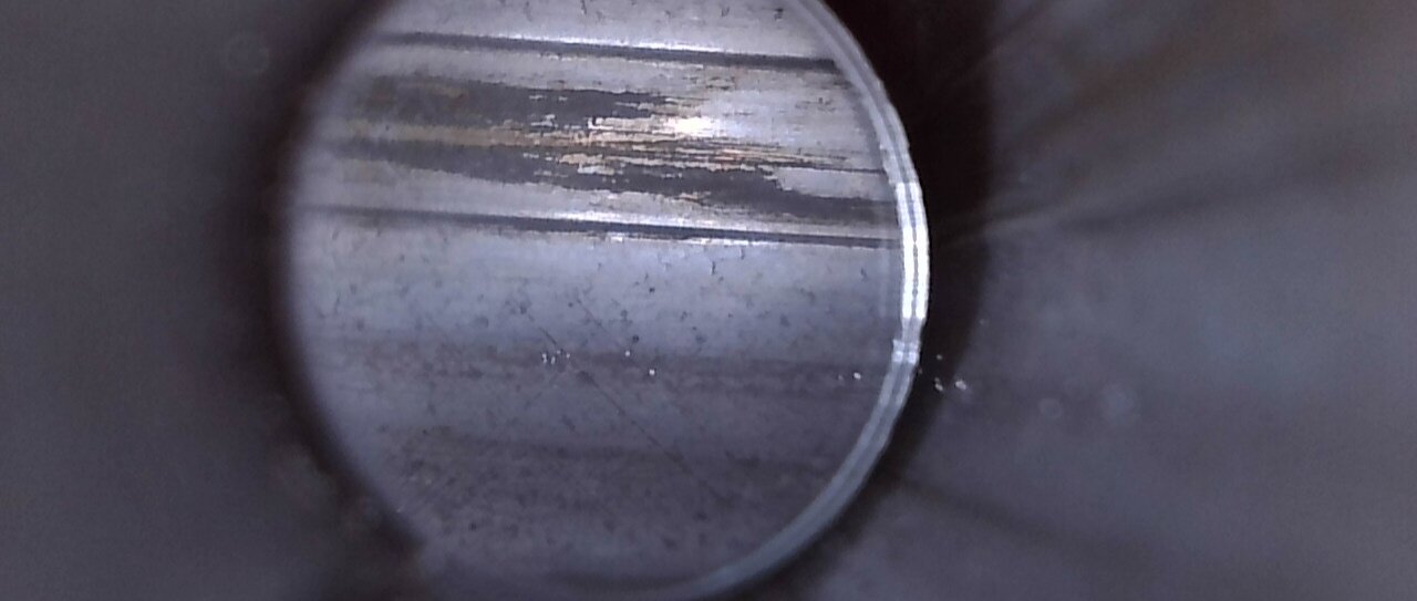

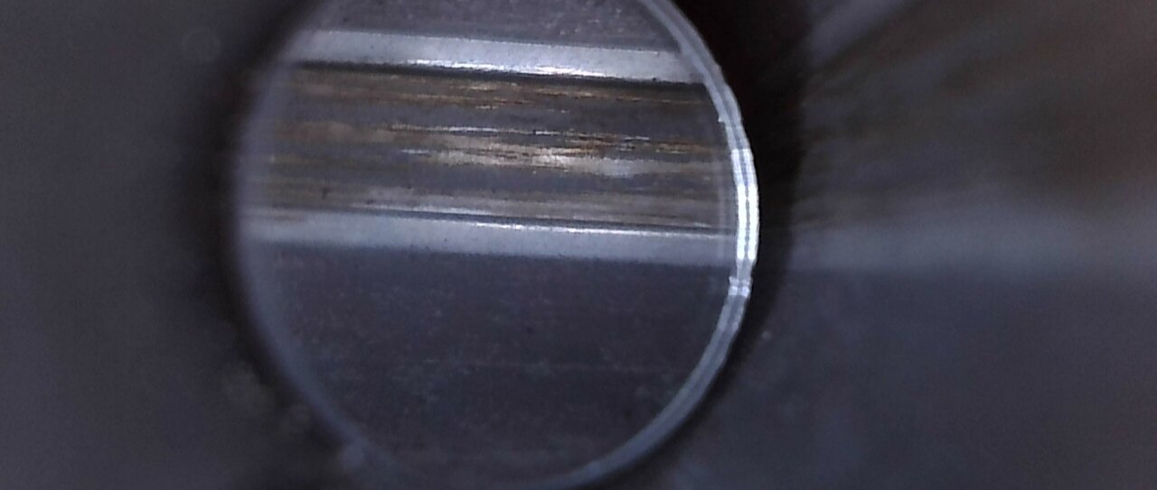

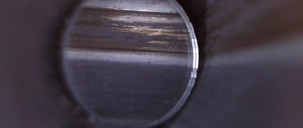

Carbon build up after 24 rounds suppressed wasn't anymore or less with Reloader 16 than any other powder, but copper from these monolithic bullets was. I will have to watch this in the long term.

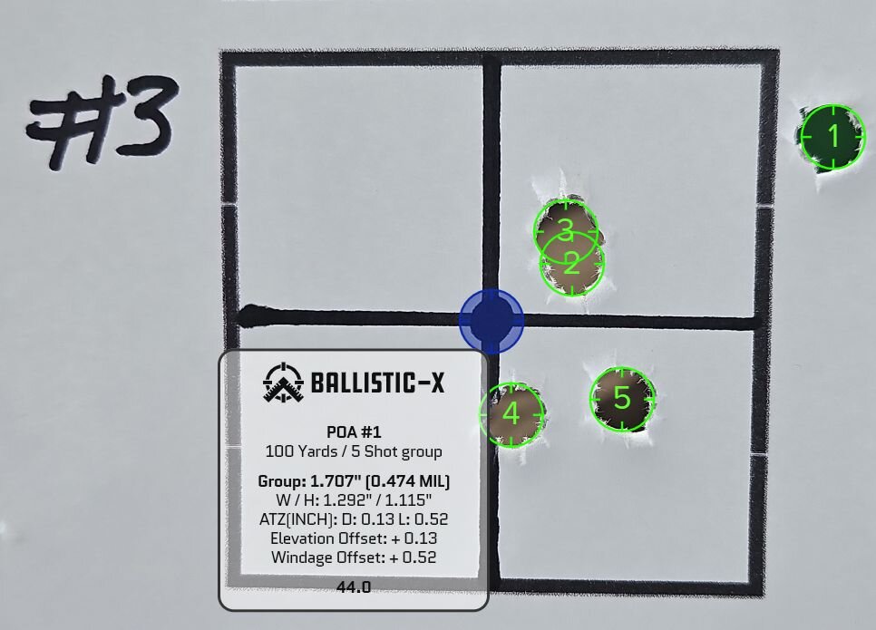

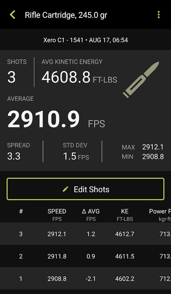

Testing went pretty good. I may have choked the 1st ladder test. I cleaned the barrel in prep for these solid copper bullets and fired 4 fouler shots to settle the barrel down. Speeds on t he 4 were 2758, 2748, 2724 and 2730. I kinda thought the barrel has settled down, but I may have been wrong or? Looking at my graph, I just don't know.
I did notice an overall increase in speed on the 2nd ladder v's the 1st.
43.7 had speeds within 7 FPS of each other, but POI was very nice. 43.9 had good POI, but little more spread on the velocity. Test #1 had a very defined flat spot between 43.5 and 43.9. First test POI's were all on top of each other. 2nd test POI was bad as indicated by speed. Test 2 had a flat spot from 43.9 to 44.3, but POI was no where near together. What I did notice is a consistent dip in velocity at 44.3 with a spike at 44.5. My guess is there is something going on with case volume at that charge it does not like. Sometimes this ladder test works like a charm and others it does not. It was cool to see the difference though. It did prove that this combo like somewhere between 2910 and 2960.
I'm going to explore 43.8, 44.0 and 43.5 at this seating depth.

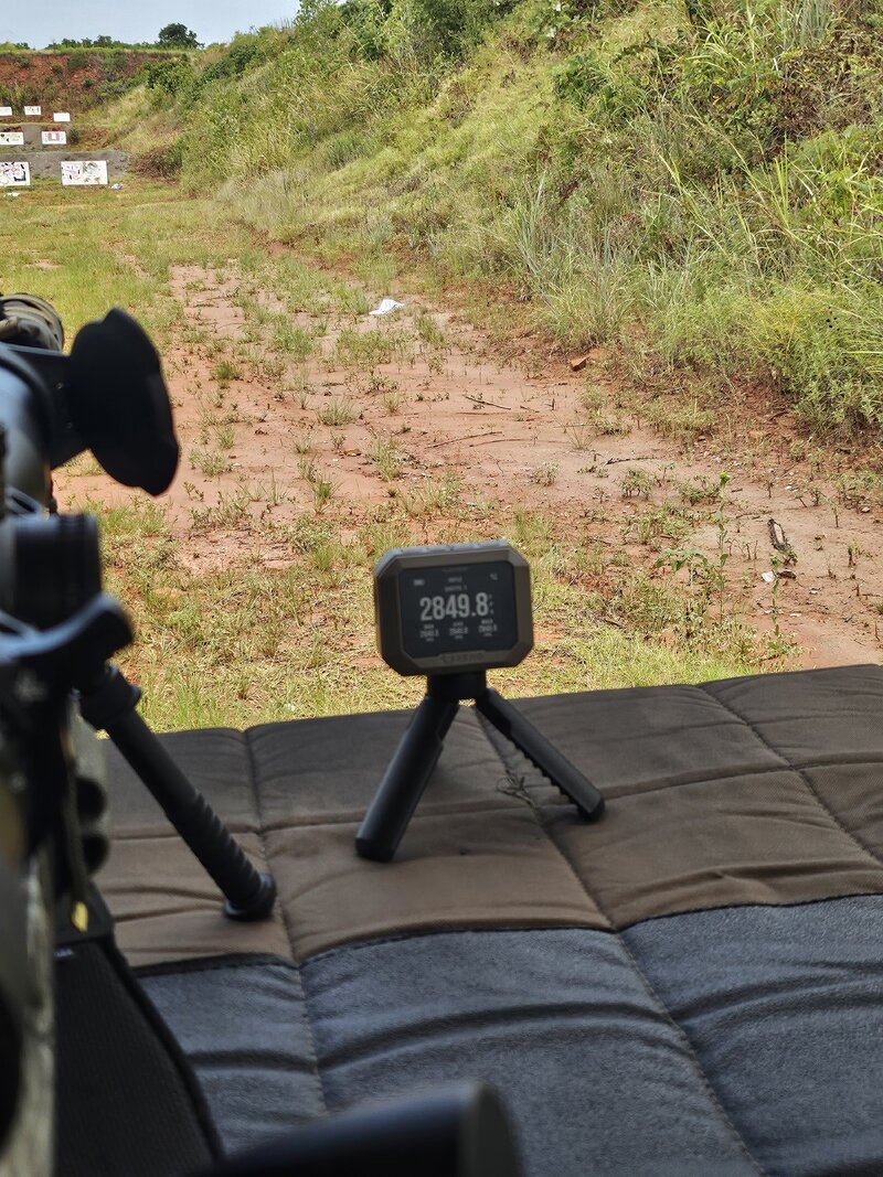

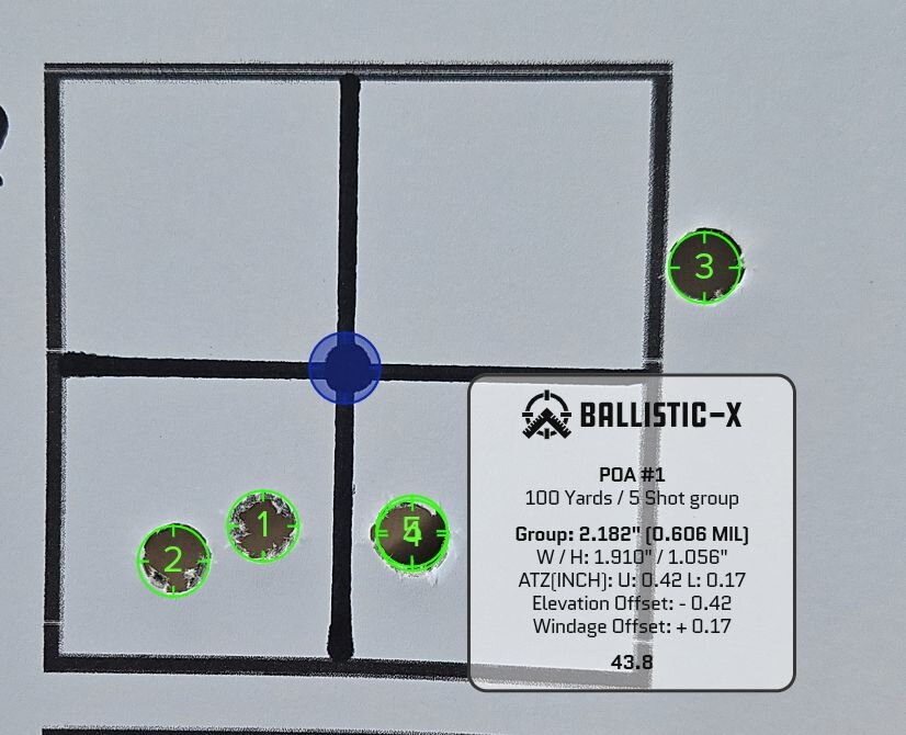

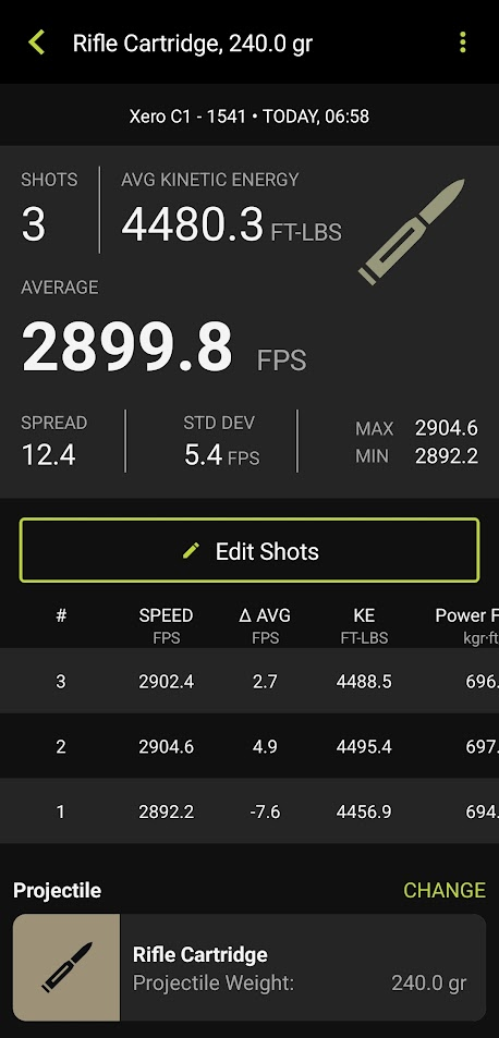

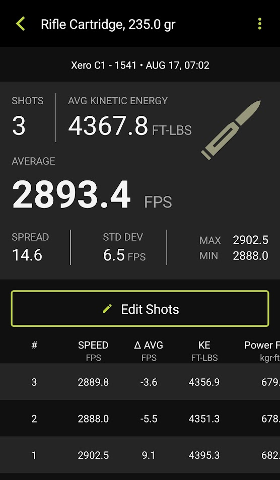

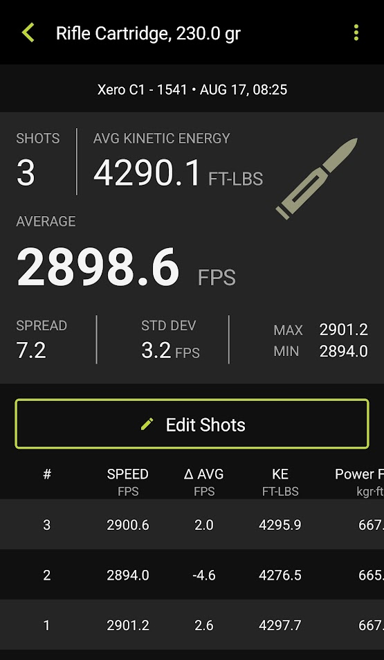

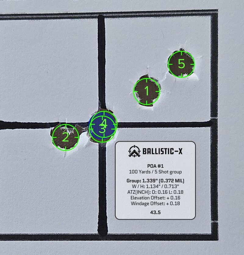

Groups this morning weren't as good as I'd hoped, but I do have something to work with.
43.5 @.050" jump
SD: 11.1
ES: 25.4
Average: 2907
Shots 1 and 5 kinda had a mind of their own. ES was high, but what makes me think this group has potential is shots 2-3-4 very close and 2897, 2899 and 2896. Shot 1 was over 2900 at 2919 and shot 5 was 2922.

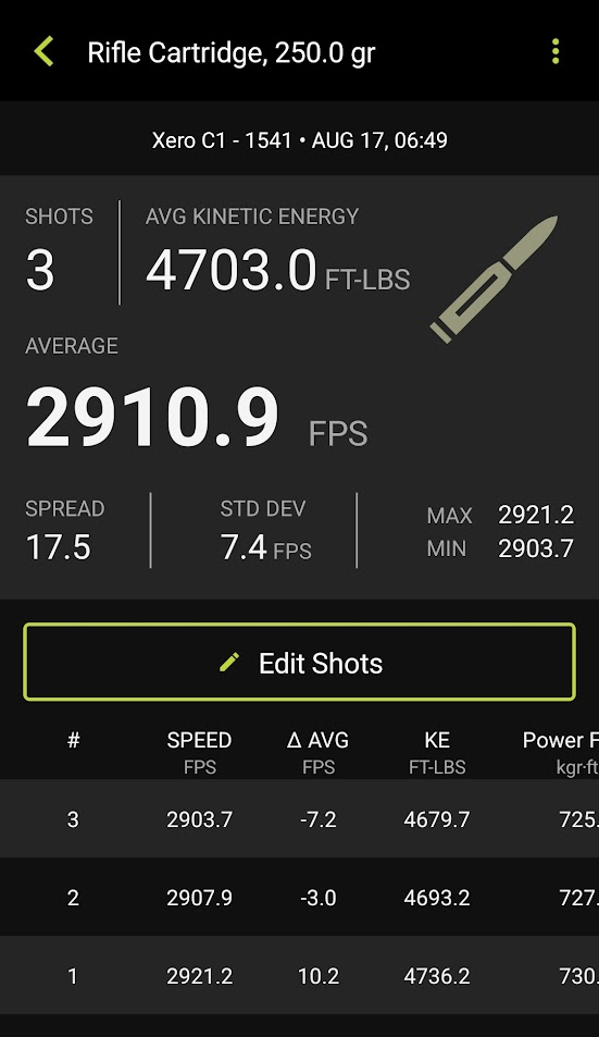

43.8 @.050" jump
SD: 8.8
ES: 26.4
Average: 2920
Shot 5 was way under at 2909, but the others were fairly decent. Even though the SD was lower, those 3 from group one have me thinking it needs a little slower speed.
