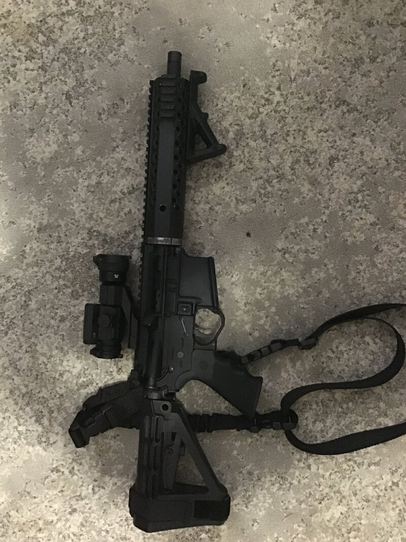

Brace pistol with 10.5in barrel. But they are not light like that 22lr.

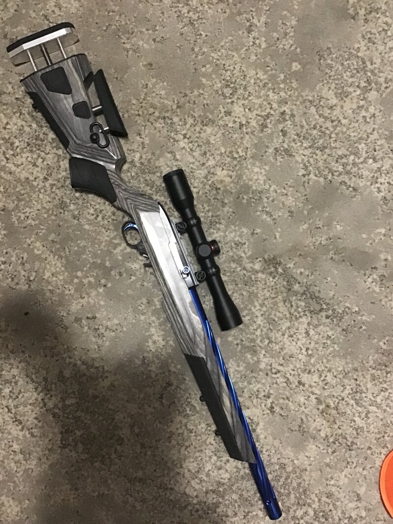

Looks like you might be building a custom rifle for her.
Yeah LOP is a big issue. She shoots a little Savage Rascal right now. If you know how small this rifle is...you get the idea.
Little is kind of an understatement. Her new nickname is Dot.
I’m wracking my brain trying to suss out how to get a center fire in the form factor of the Rascal. The 5.7 does seem like the best candidate simply for the bolt face diameter. What I wouldn’t give to have my old shop right now.

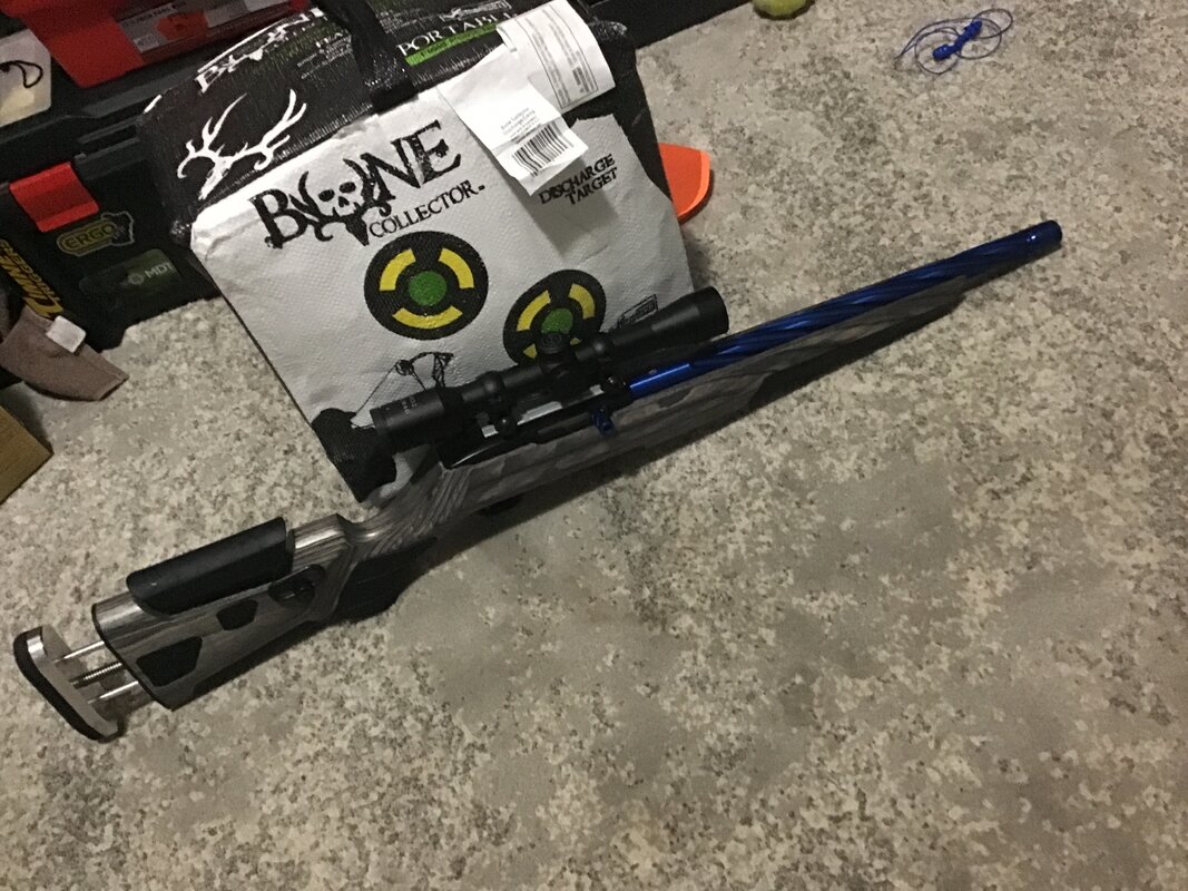

Now those are cool as shit! I can’t wait to get one for my son, do they make boy colors in the laminate?
I’ll have to get a pink one like that for my daughter when she’s old enough!
The one I bought my son was a plain brown stock. Those little rifles are stoopit accurate. I think I liked shooting it more than he did.
