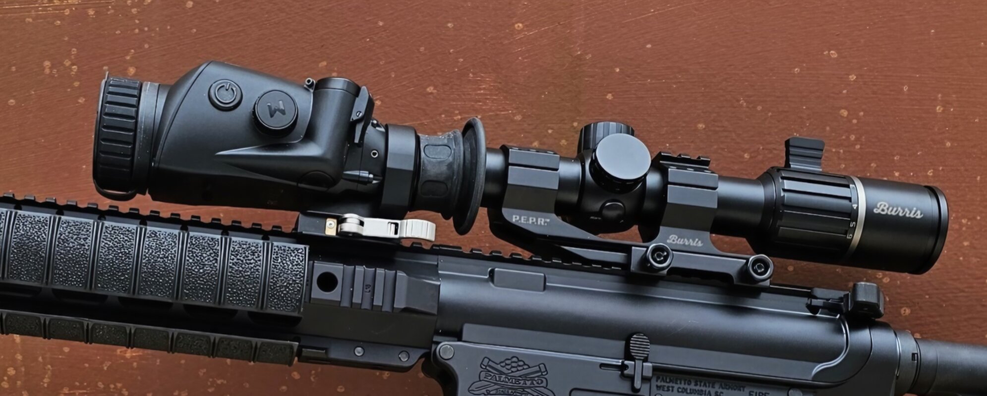

I had no idea what I was actually doing when I mounted this Burris setup to my Sabre .308 upper. But, it works. This is the Burris clip on with the adapter specifically for the Burris LPVO. I'm actually really surprised how good it works. You do lose detail and resolution as you dial up the scope magnification. But it's only an 8x scope so it's not too bad. You don't need the rubber eyecup but I left it on because I'll lose it if I take it off. And, it doesn't hurt anything being left on...and it's always there if I decide to detach the thermal and use it as a hand-held.
So it's just sticking out there with no support on the bottom side?
No support underneath. The ring clamp mount over the scope bell seems very secure. This is how they sell them and if it were a problem they probably wouldn't. I might not feel as comfortable trying this on a 30mm tube body. Much less gripping surface. The clamp ring allows quick removal and reattachment. If given the choice I would prefer a pic. rail quick release mount, but they only offer a screw down rail mount which would make it difficult to take off and use as a monocular. This type of ring mount keeps everything coaxial where their rail mount might not co-witness with the scope height on your given rifle. The downside is you have to purchase a different clamp mount to move between different scopes with different diameter o.d.

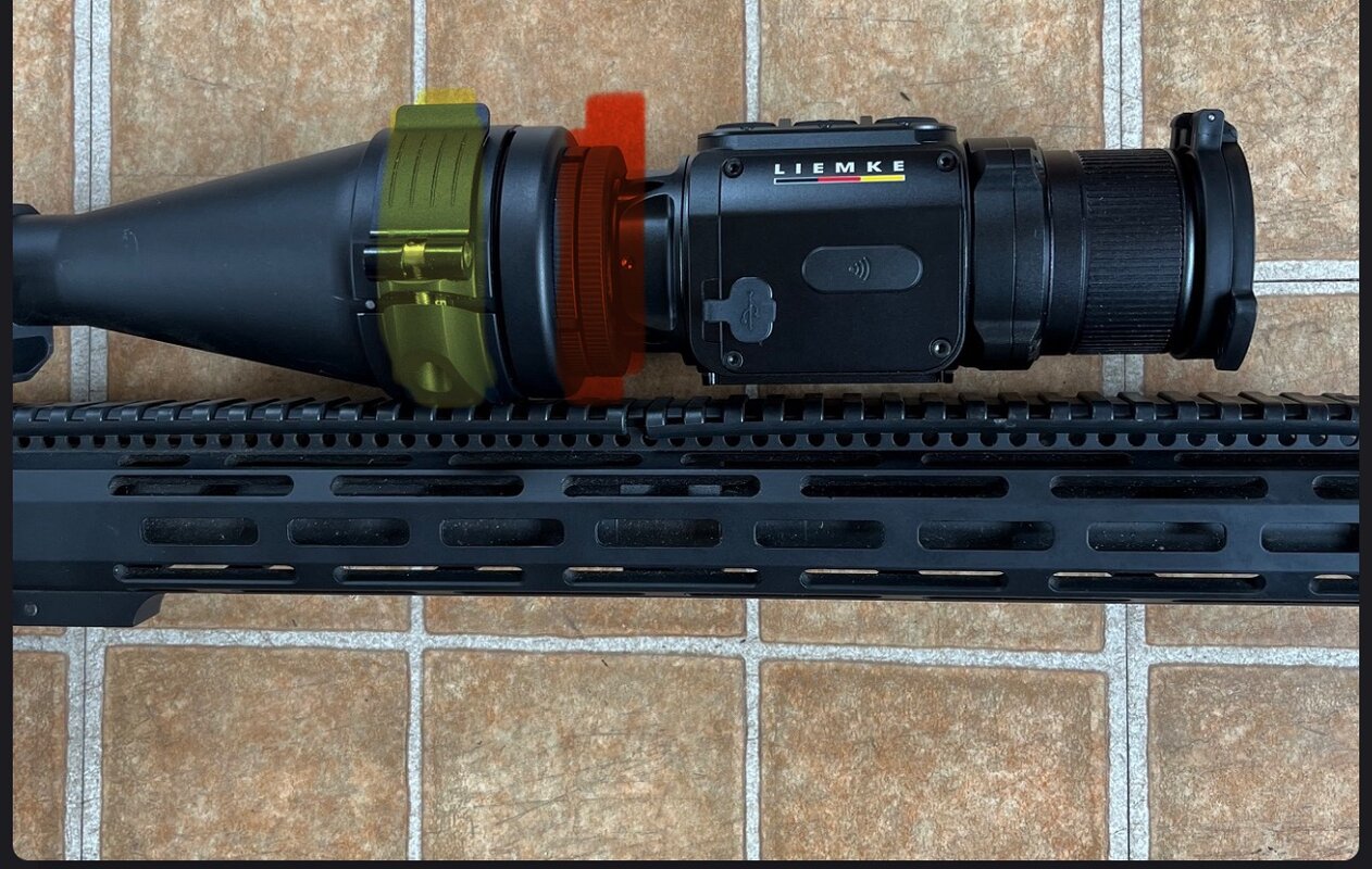

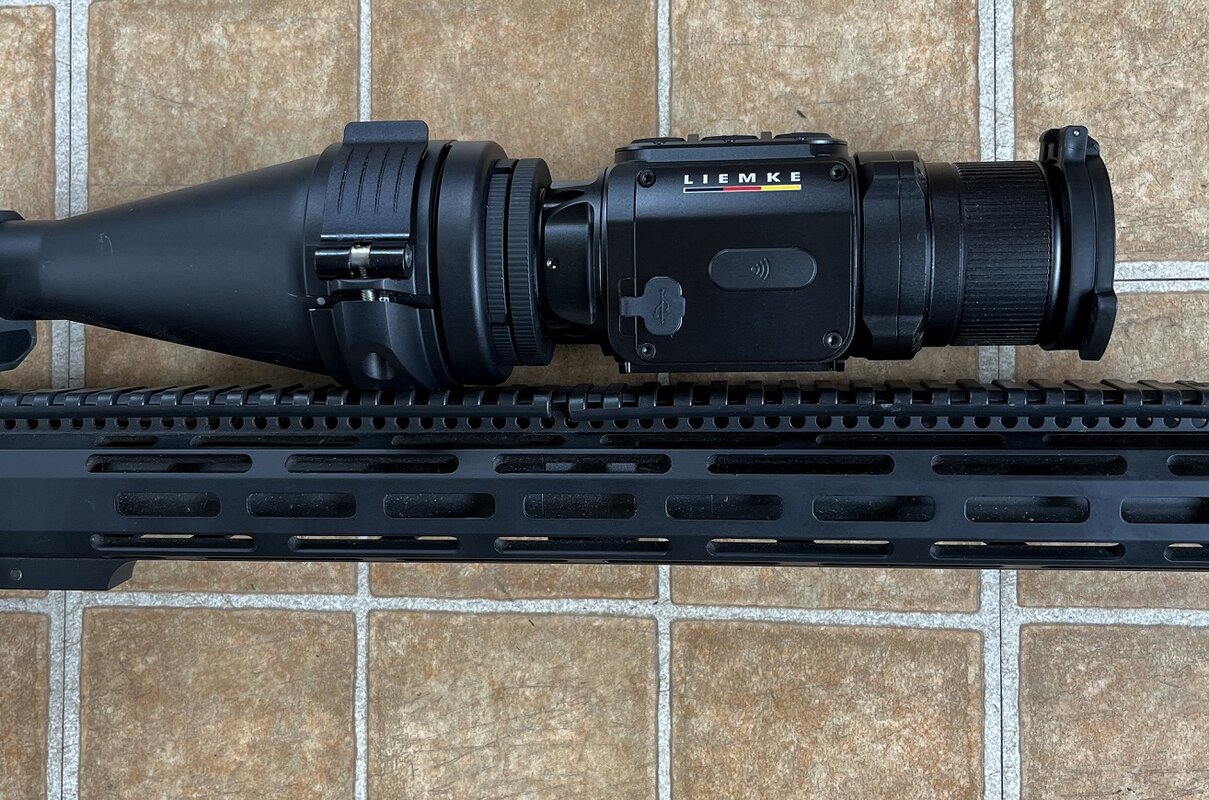

Just the piece in red. I had to buy the yellow clip on mount extra. You have to buy the one for the o.d. of your scope. FYI the red adapter will screw right into a 50mm scope, but it makes it a lot more difficult to get it on and off quickly.
Thanks for the prompt reply! I received a similar adapter to what is in red, but mine is somewhere between 40mm leupold and a 50mm Zeiss I had on hand . I’m headed to Cabela’s to hopefully find a scope this adapter will fit so I can check it out under magnification. I didn’t want to order a separate adapter yet because I thought it would direct thread to a 50mm like yours. I’ll be getting some if I keep it though
They also offer a picatinny rail mount, but it’s not a quick release.

I went to Cabela’s and tried the included “mount” on probably 10 44-50mm scopes. I found a vortex 50mm that felt like it worked, but once the scope and thermal were coupled, the threads wouldn’t hold and the coupling slops around inside the objective of the scope so I took it off. The view while looking through it as a hand held is very impressive though. @Kingfish, if you dont mind my asking, what make/model of scope were you able to direct thread their included mount onto?
It was a vortex viper 6-24 gen 1. The gen 2 is probably the same tube. I don't know if you caught it in my earlier post, but when I mounted it that way, all I could see was a small circle less than a half inch in the middle of the scope fov. If I had to guess why this happened was because it placed the eyepiece of the thermal too close to the objective lens of the scope, but that may or may not be the same with all scopes. I'm no optics engineer. Using the adapter ring attached to the clamp mount spaces the eyepiece further out and may make that necessary to fill the fov on any scope.

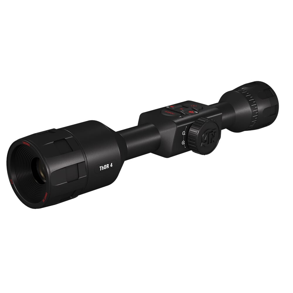

I'm not an ATN fan...but it's a decent entry level device if you stay open minded. I personally think that entry items tend to taint people's opinions on thermals...usually in the negative because they don't perform as well as people would like to think.
Has been my experience with a lot of entry level things, of all different kinda.
