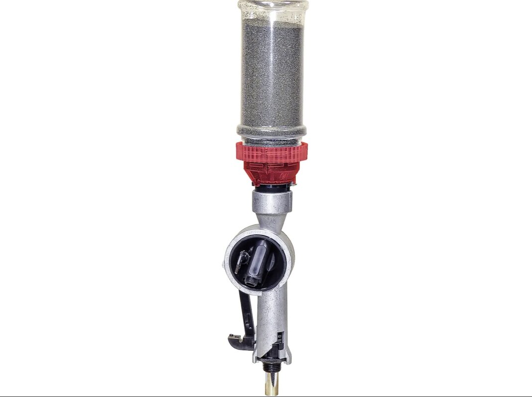

Yep I’ve run h4895 and 8208xbr for vmax hunting loads and I use my chargemaster. For my 55gr fmj and sp bulk loads I run them on my Dillon 550 with tac in the powder dispenser.
This is provided you don't spill shit all over your bench because you forgot to close the valve on your measure
