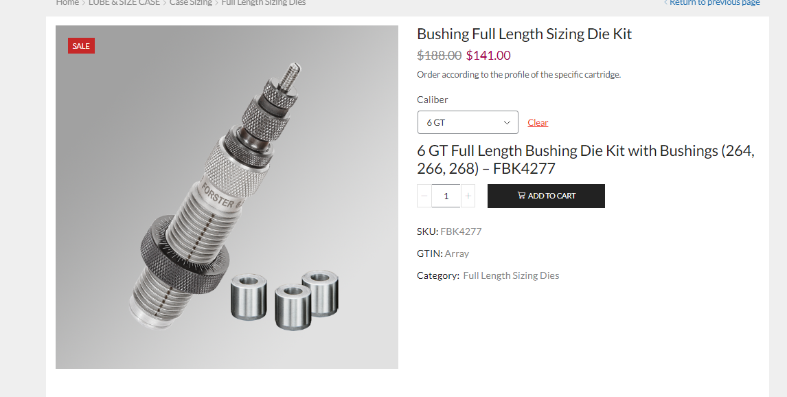

I have hornady Dies but just classic set. They came with the rifle. I thought about getting mandrill die for it. But I’ll have to look up full length neck bushing die.
I was just looking at the foster die. Really don’t need the setting die as I already have one. Redding looks to sale as a set for what I’m seeing. I’m looking around. I have about 40 or so pieces of brass to fire form before I start having to use a die.
My guess is Redding sells the die by itself. Not sure as GA is the brains behind the 6GT so maybe they have the rights? I just love how those SAC bushings keep the necks uniform.
just ordered the fosters die. Now for the bushings. SAC here we come.
Not sure if the SAC's will fit them. They didn't 2 years ago when I bought my 6.5 die. Their bushings were proprietary for their dies. The SAC bushings work in RCBS and Redding that I know of.

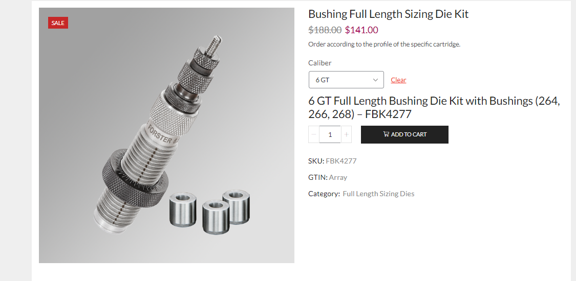

Looks like I’m canceling my order😢. Foster bushings it is.
Sorry man. I forgot about that.
I usually get a Forster set with the 3 bushings. I'm 3 for 3 on the correct bushing for getting .002" neck tension.
