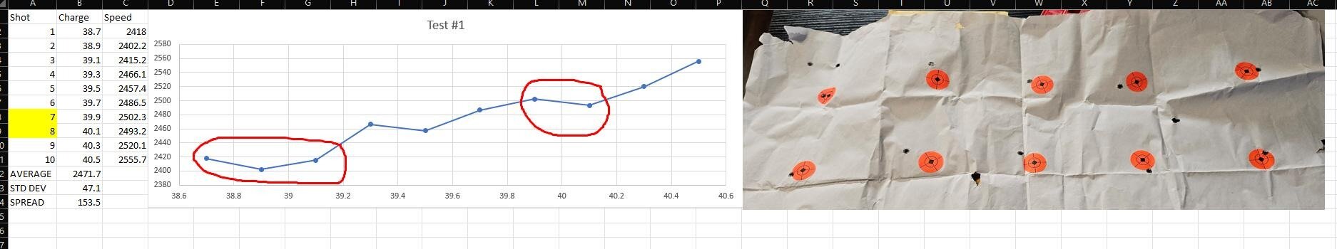

Satterlee test
Try (when you have 10 rounds that all registered) putting the data into a spreadsheet graph
Edited:
This is my method
I would load up 5 of each of this, and maybe split it with another 5 of 45.1 just to see. See what the SD/ES is for those.
