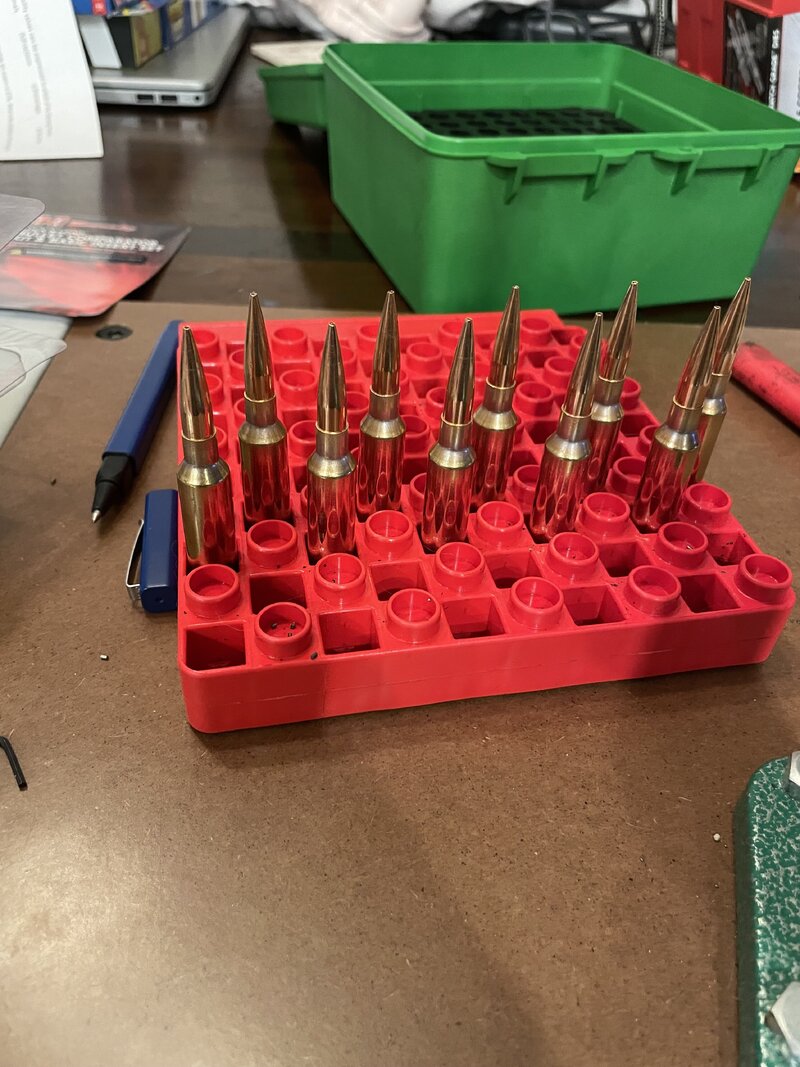

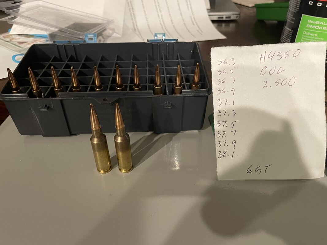

They can be loaded loooong. Mag has plenty of room. I loaded to C O L 2.500. Get a base line load then start setting them out if needed. Heading to the range tomorrow afternoon.Man those 6GT cases are sexy!

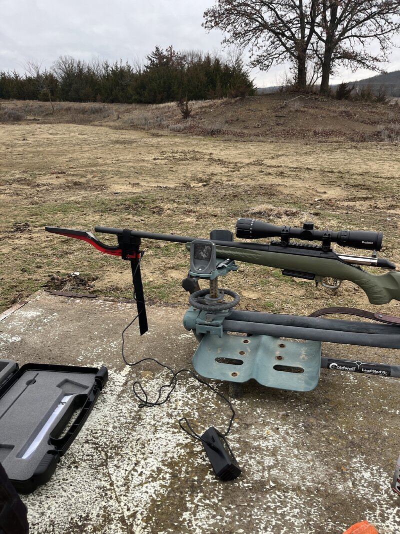

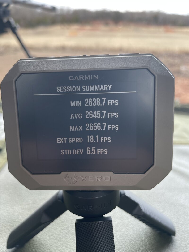

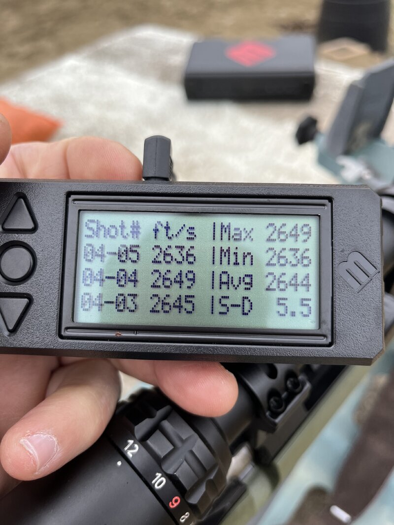

My old Oehler was such a pain to set up. I ordered a labradar before the Garmin was available. Steep learning curve on getting sorted out, but so much better than setting up the Oehler.I don’t want to sound like I’m bragging but I’m glad I never have to unpack my Caldwell again. You need one of these Garmins. We just passed Christmas. When’s your birthday? Early Father’s Day?
I really think I had my Caldwell kinks all figured out but I’m pretty sure life’s gonna get much better from here on out.

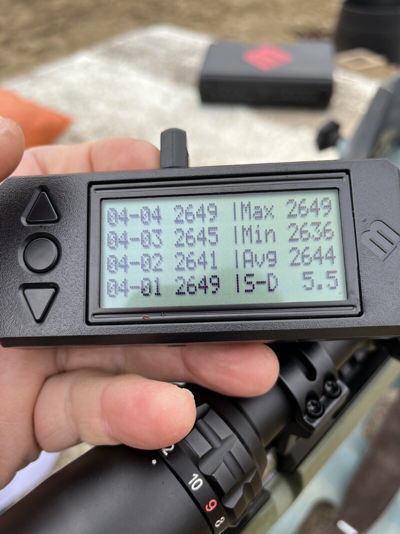

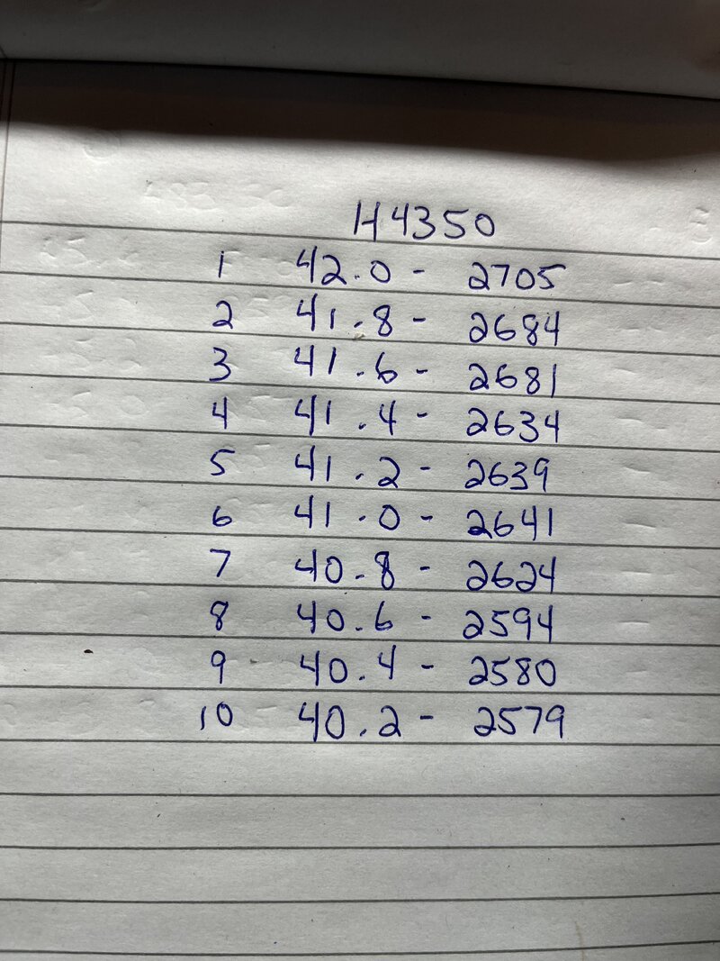

now how hot do you want your load. I see 3 good nodes.I done another test with H4350 140 grain SST’s using the magneto speed V3 it’s so awesome to have a chronograph that works!View attachment 2949
I didn’t shoot at paper figured it was a lost cause with the wind blowing like it was I came home and loaded 5 more to shoot at paper tomorrow if the rain holds off and the windLoos good. How did it group?
