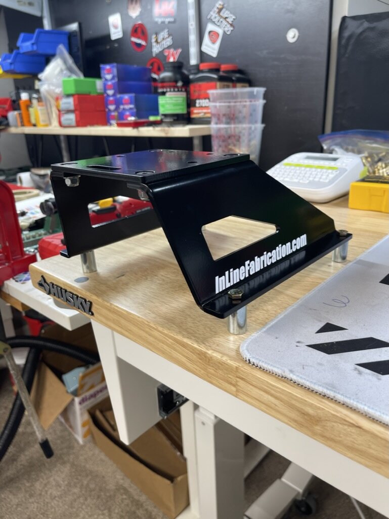

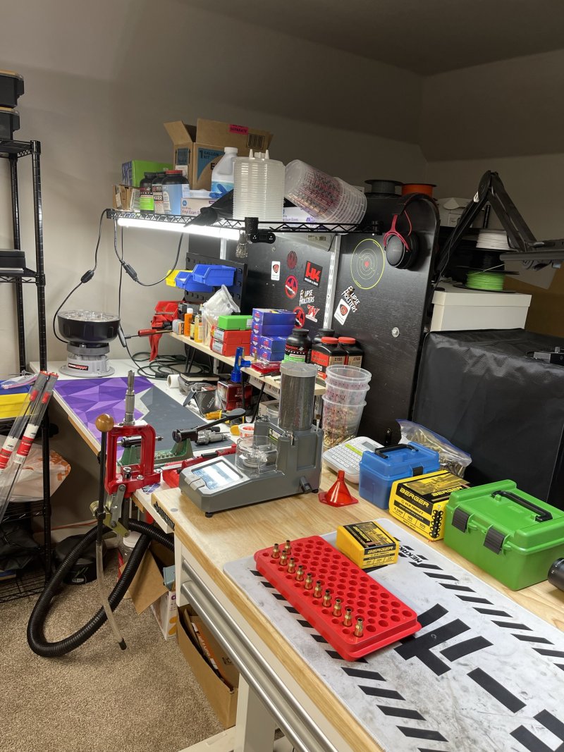

Well my new setup is a bit delayed in shipping. But I was able to get my mount up at least. 4" mount but added 1" steel risers.

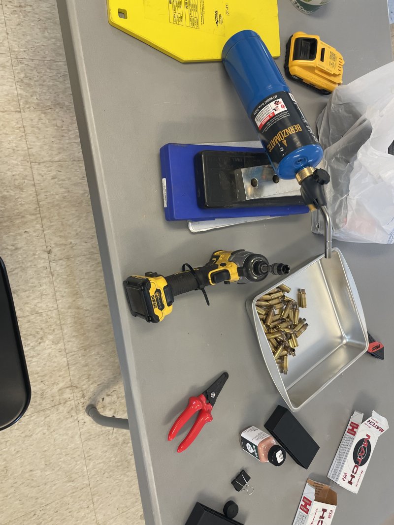

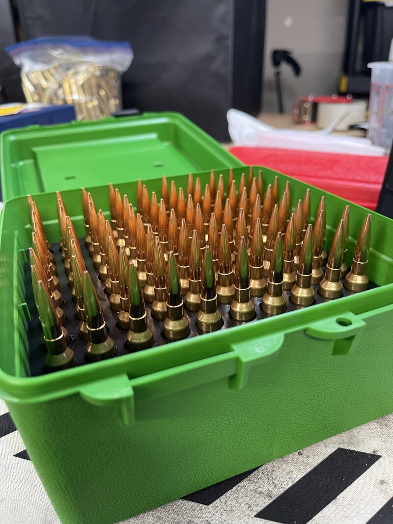

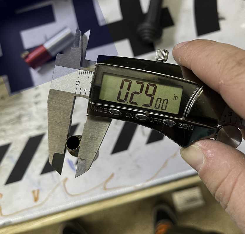

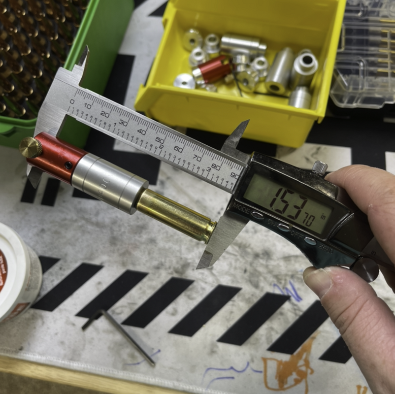

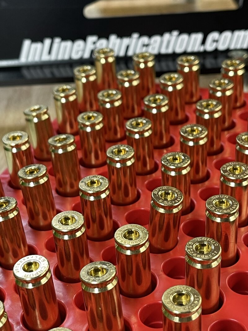

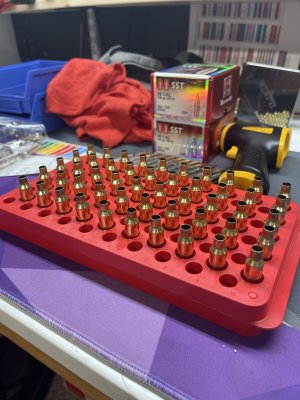

So much prep. Got new brass finally. No more Hornady factory match or Starline. Ran 100 cases over a mandrel, trimmed/chamfered/deburred, primed, loaded, and bullets seated. I have 20 more to load of the 100 case lot. Time to fire form, then the fun begins!
8338522E-61FC-4895-A1FE-977BE3A9DE2F_1_105_c.jpegA097BB0D-E736-4E7A-96C7-58B99365DE11_1_102_o.jpegE0BB58FE-EA8E-45F8-ACB2-56A3709BE4C0_1_105_c.jpegBD5F80BE-CC84-44A2-8855-8D505FF24BE2_1_102_o.jpegBCAD74C7-7D30-4C65-A64A-D13D600517C2_1_102_o.jpeg

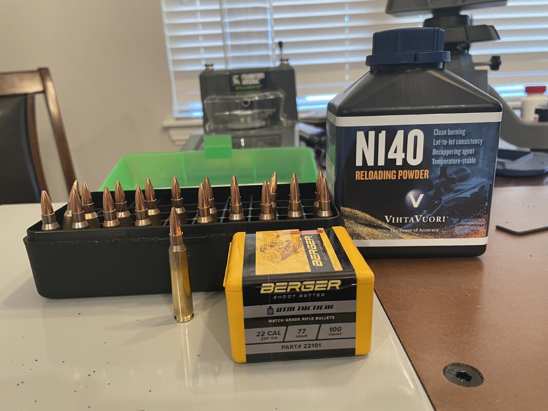

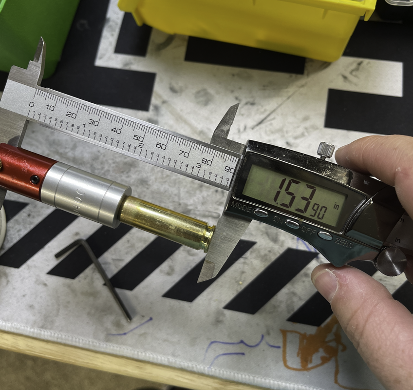

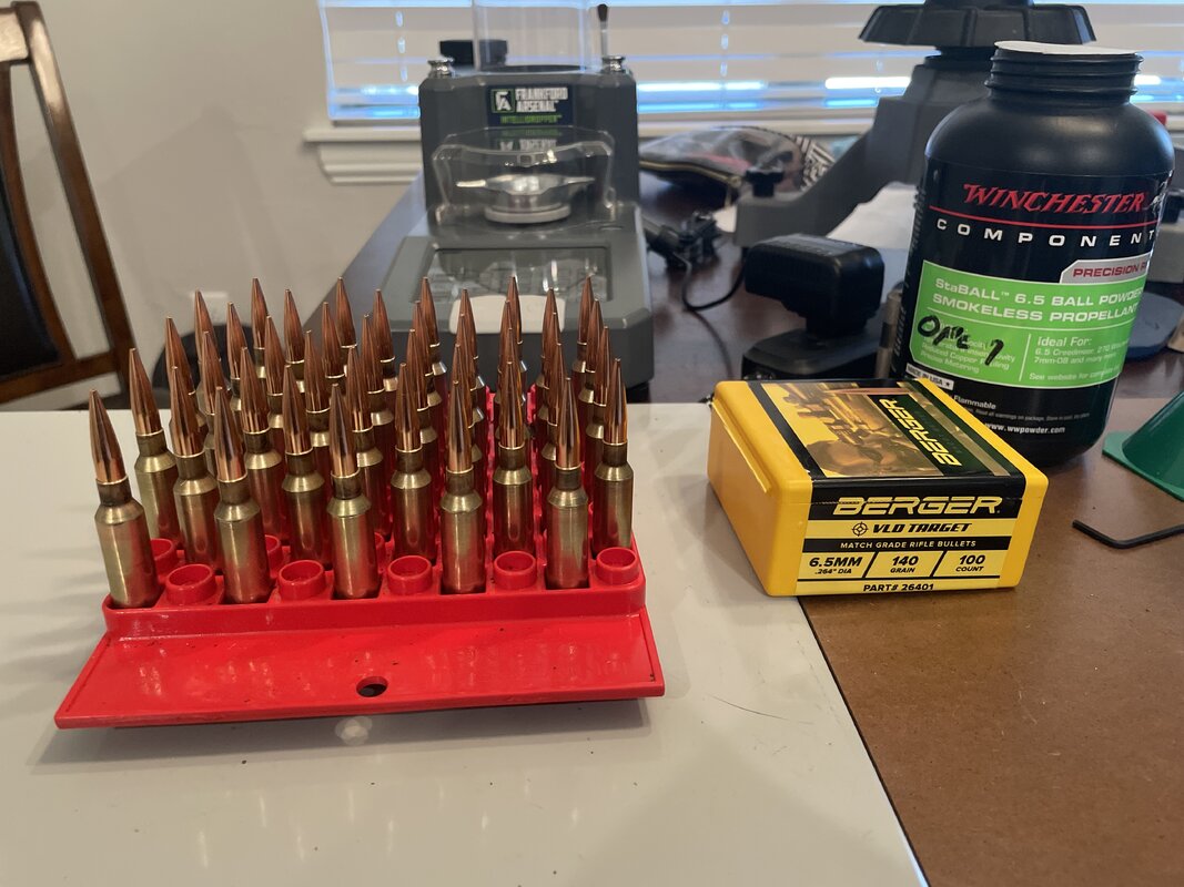

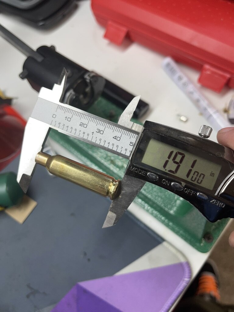

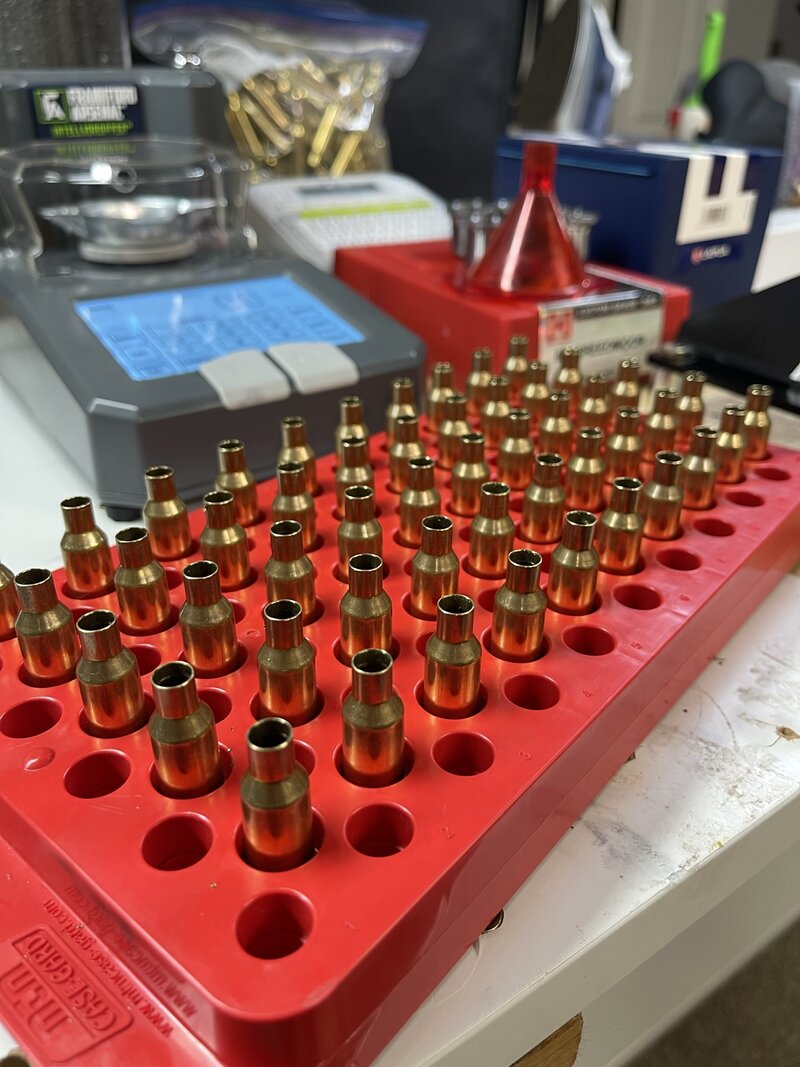

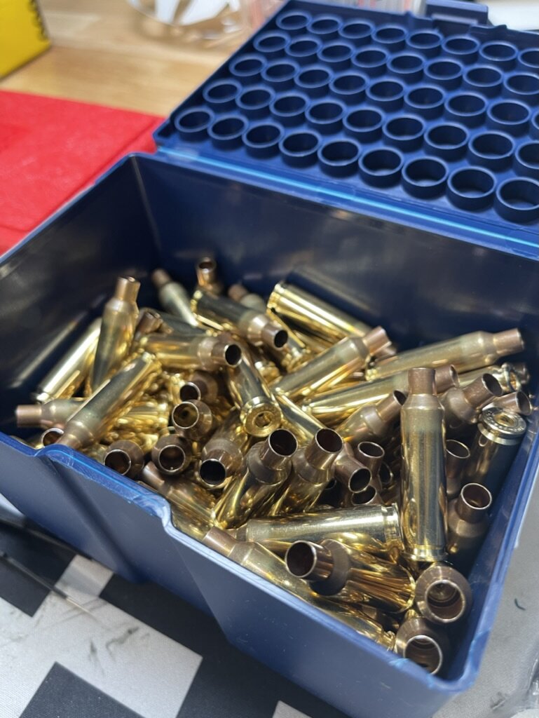

Just started brass prep on 6 ARC and 6.5 CM. Annealed, de-primed, now tumbling. I will be sizing in a couple of hours. I will be heading to the range later this week to try out the new Garmin Zero. 😎glad to be back home in the reloading room.

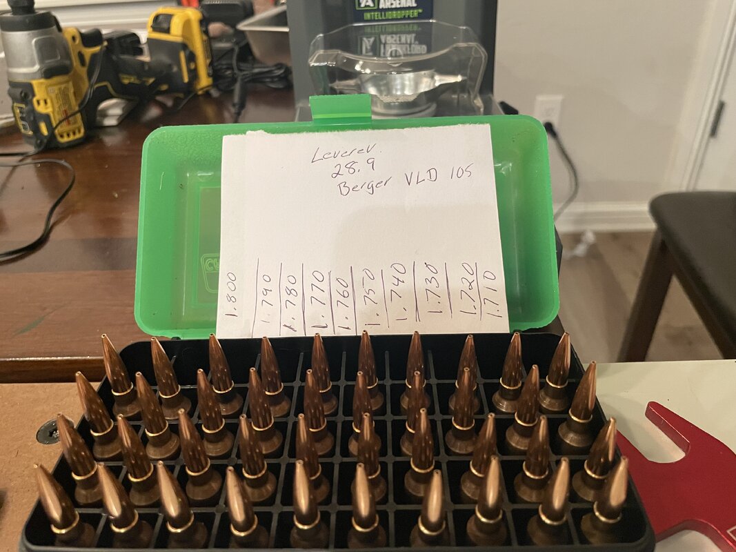

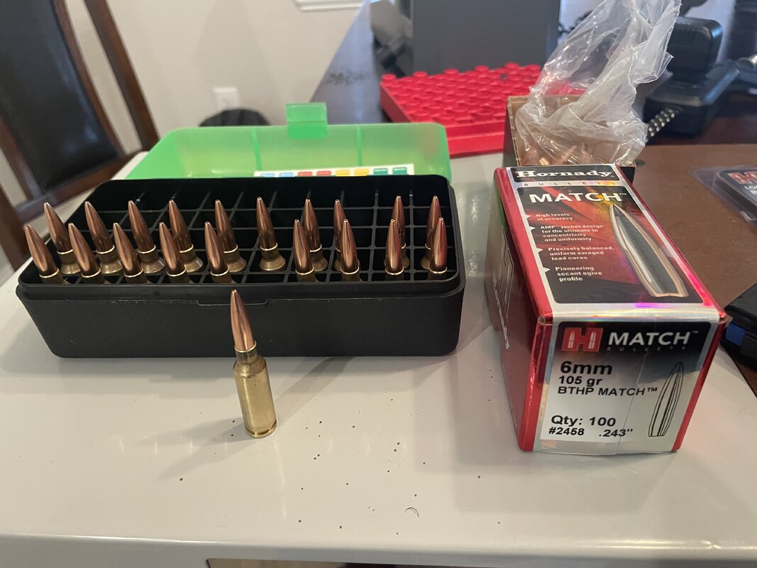

6 ARC out of a gas gun. Bumped every 4th round. Going to start looking for sub MOA out of these. Let’s see if we can find it.

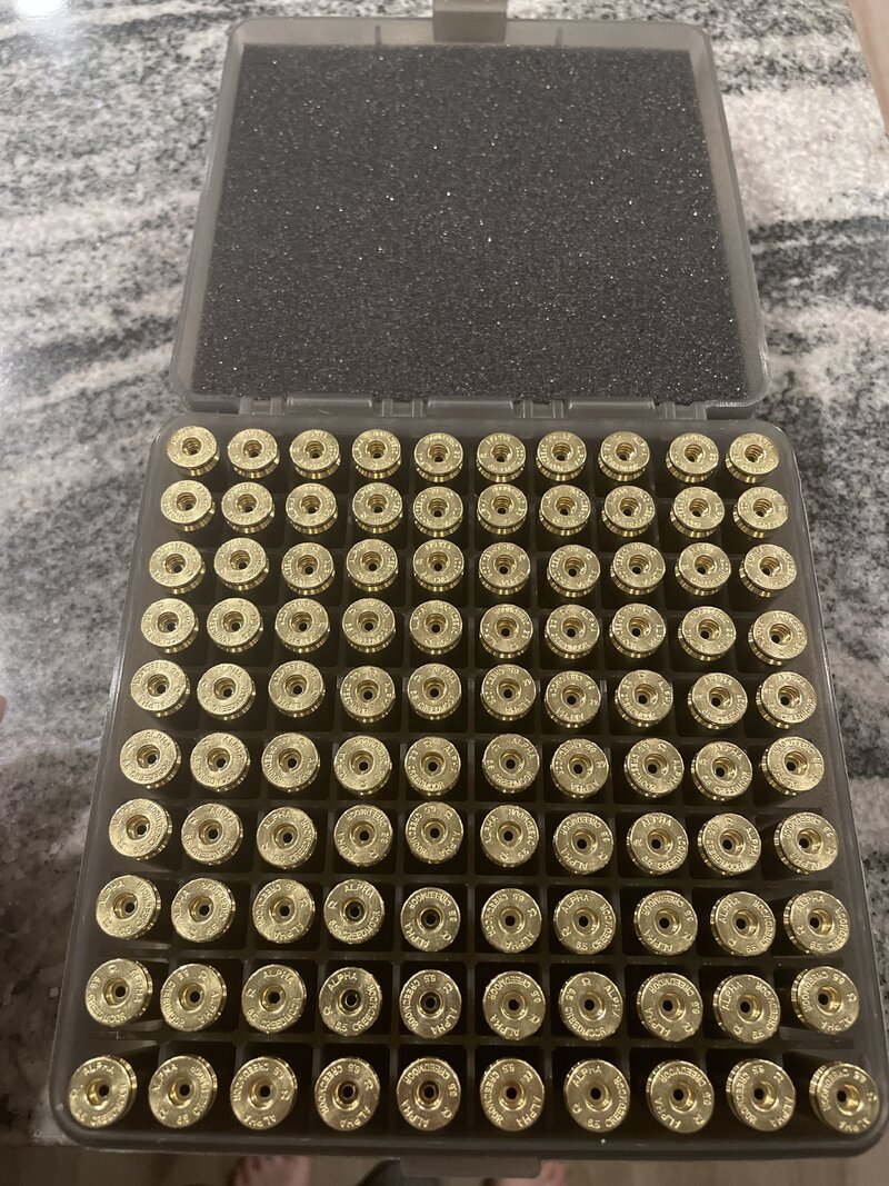

Just got 100 rounds of 6.5 alpha SRP brass. Let’s see how it works. These are for my bolt rifle. Going to keep the LRP brass for the gas gun for now.
When I needed brass on my last bulk buy, Alpha was out of the SP stuff so I went with Lapua as it was in stock. I've been pretty happy so far. The load kept about 4.6" over 5 shots @1000.
My next lot will be Alpha. I've been more impressed with it over the past year than my Lapua
